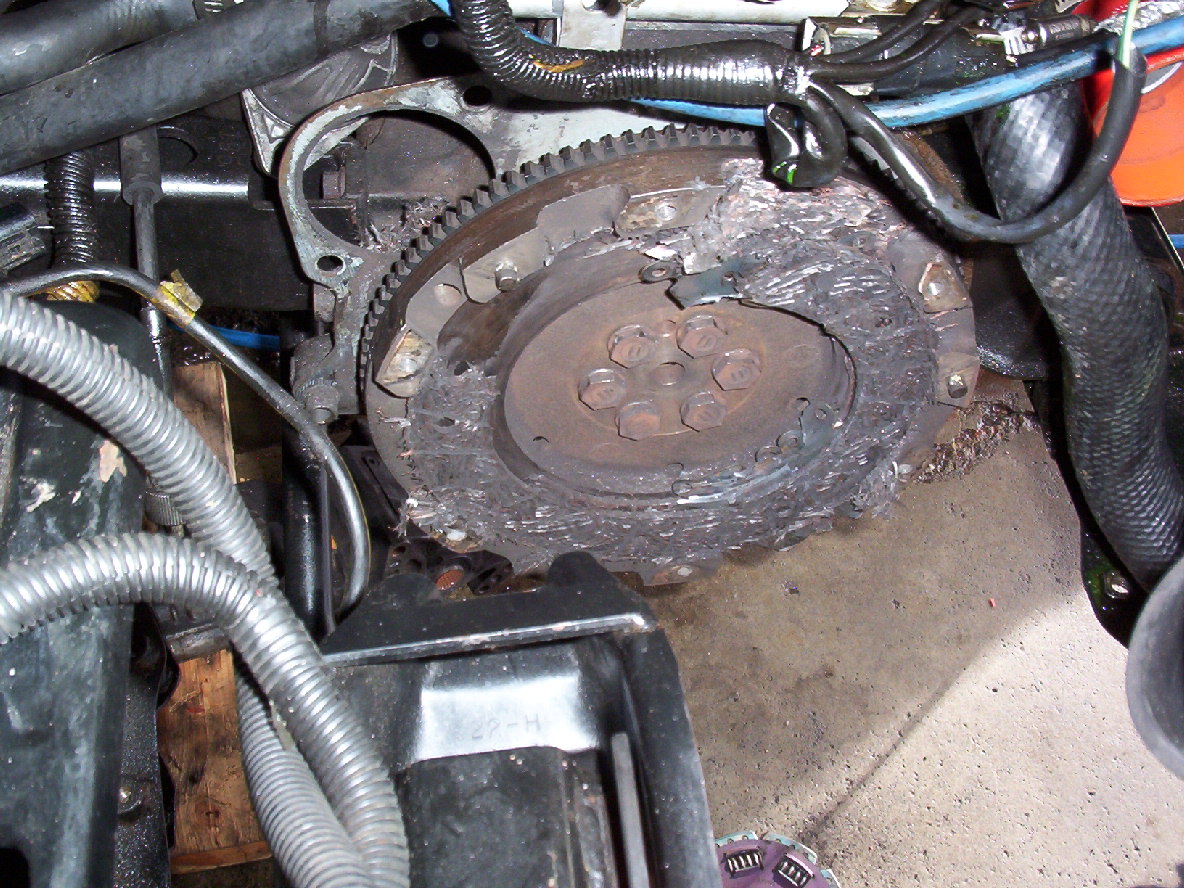

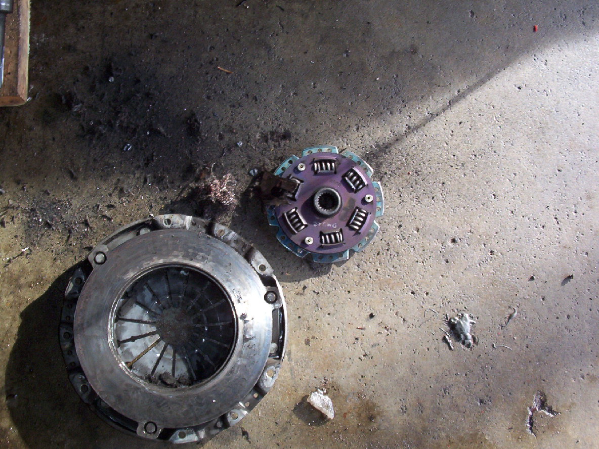

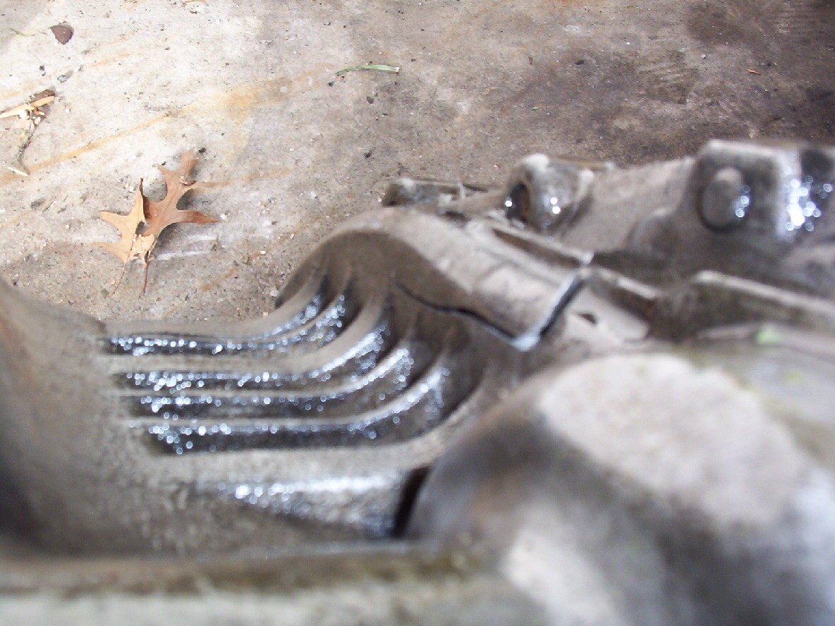

Re: Blew Up Drivetrain :)
Pic#1-Clutch still on flywheel
Pic#2- Clutch Center
Pics#3&#4-Tranny case

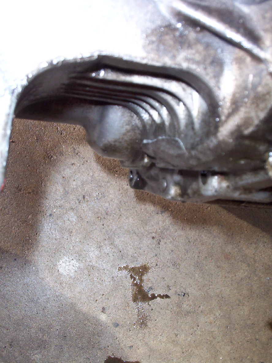

#4

Blew up the center diff. I'll take the case apart and see what really happened. And I was surprised the flywheel has no damage to it. The pressure plate cover is a little beat up on the outside, but Im sure I can get by with just a new disk. Oh and I was happy I pulled the tranny by myself in my garage in 3 hours taking my sweet as time.
WHAT?!?!?!?!
That shit needs to go bye-bye.

Damn, that is fucked. Im with Vicious, from the first pic I would replace anything that disc touched.

Being that the center Broke off wouldnt that make the disc just sitting there and not messing up the surfaces that it was on? It wasnt turning anything or being stoped it was moving freely, turning with the flywheel and PP. Just my thoughts.
Can you say "heat damage"?
-Yeah, but when sumthing locks up in your tranny, and the input shaft locks... U still have a rotating flywheel and crank shaft, at like over 3k rpm... which would have enough momentom to rip the rivits right off the clutch....
Which is what happened.
Whats the worst reusing the flywheel and pressure plate could do?
Chatter, not hold under power, or worse. If there are heat cracks in those components they could spread. Which could cause them to fly apart at high rpm. Basically sawing your bell housing in half at worst and taking other components out with it.
It's hard to tell by the pics how bad the flywheel really is, but that pressure plate is "blued" pretty good. I suspect the flywheel is the same.

wait, maybe I'm missing this, so why did your tranny housing crack?
The center diff wanted out. Fast.
Old 12-30-2005   #19
And also my input shaft (?) snapped.
