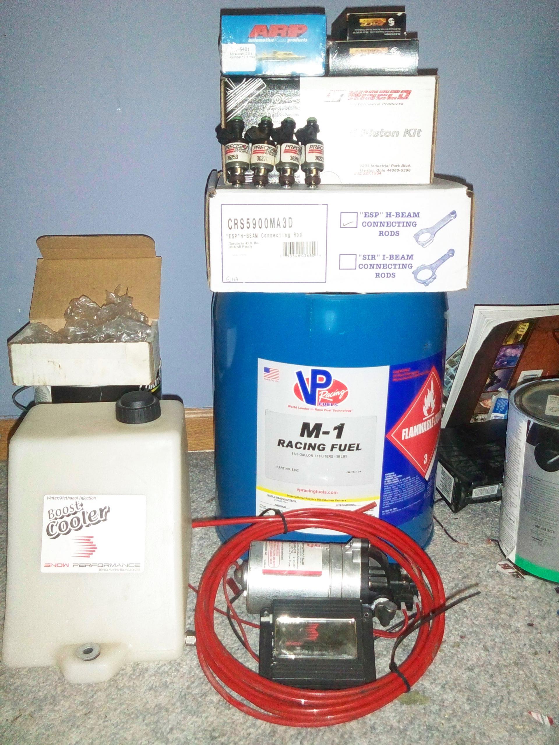

here is my kit and parts i have got so far
1991 Eagle Talon awd
2.0 fully built lower-end
+more mods to list
